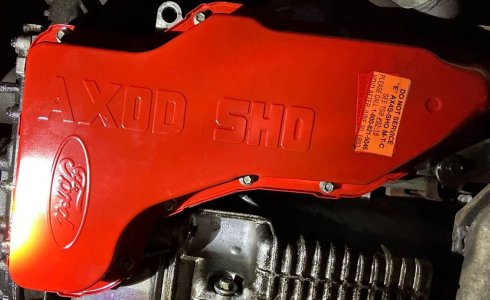

I did just as Chad suggested and it now shifts as good as I would think it shifted when new. It isn't a crisp shift, but I have read that these cars never had a crisp shift. I bought 2 bottles of Lucas, put one entire bottle in, and left room for either another quart of Mercon or the 2nd bottle of Lucas. I am leaning toward the 2nd bottle of Lucas. Thoughts?
While I had the pan off, I gave it a coat of Ford Red. :thumb: Thanks for the help!SHO Trans Pan
