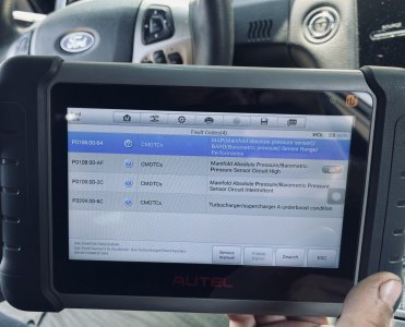

Map sensor omg do I gotta re tune because of this if so it’s gonna be a headache

I would check your MAP sensor and the wiring to it first. You're throwing three different MAP codes and an underboost code which is partially determined by your MAP sensor. If you replace it with the same Motorcraft 3-bar sensor then you should not have to retune the vehicle. If you put the stock sensor on you will have to retune.

So I can just order new one from gearhead? N plug n play

Should I take off ground on battery when taking off old map sensor and putting new one on ?
