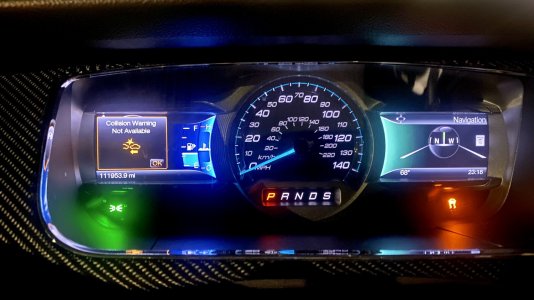

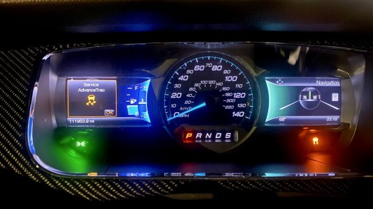

I have been getting the Service AdvanceTrac message come on virtually every ignition cycle followed by the traction light and a Collision Warning Not Available message.
Pulled a code that indicated the Wheel Position Sensor was bad. Anybody had this happen? BTW 2014 SHO non-PP w/ lane departure, auto park, pre-collision warning, adaptive cruise control, ect…
Thats when you can have fun. I pull the fuse just to get that alarm. Abs wheel sensor. May be cleaned but probably best to replace
