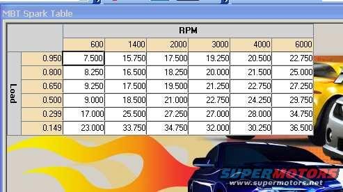

You should see the timing pulled in the peak load area. Then climb as the rpms go up.
Ideally you should be seeing something like this.
Mbt spark table 1998 sho
But in reality you should see it limited during peak load around 3400-4000 rpm.

That kicks ass, and I envy anybody who gets to play around with tuning software (I make fake engines with megasquirt's tuning suite to feel important). But why would you pull timing beyond factory at low rpms, is my question. I always thought the game was increasing spark for power.

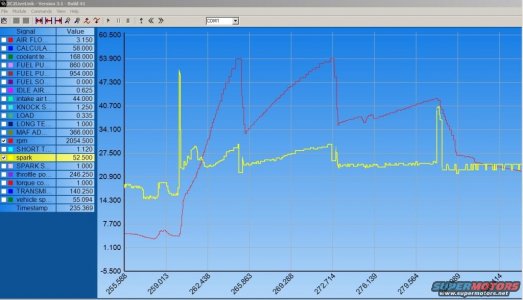

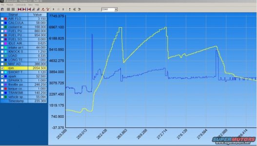

You should see spark range from 0* up to over 40* in normal operation. At WOT it is a bit different and the timing is limited to the range of the chart I posted above generally.
Here are two pics of a log from a WOT run. They are both the same run but the colors have been swapped so you can see the actual RPM or Spark numbers on the chart.
RPM
Rpm and spark
Spark
Spark and rpm
