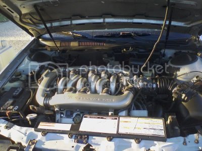

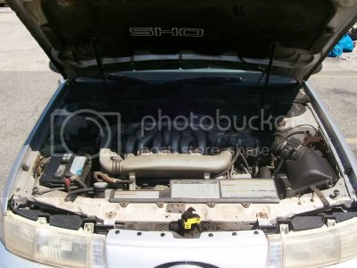

Simple green PRO-series, and a ONE hand towel on my 95 ATX FTW!
BEFORE
AFTER
M01A0279
M01A0280
Spent about 3 hours last saturday cleaning it. Not a single drop of water was used. And yes, I'm well aware that someone stole my hoodmat. Consequences of living in the "hood". . . . .
