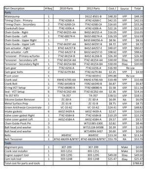

I do this for a living, but haven't been behind the timing chain cover on this particular engine. I knew this day would come and picked up the cam fixture a while back after stumbling on the thread I'm looking to revisit. I just want to read through it again and make a copy of the parts list before going to my dealer to order up.

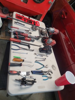

Things that ended up biting me when I did the job:
- Cam bolts are torque to yield. Make sure to order new ones.
- Required a specific 3 jaw gear puller. (Ordered from Amazon. $50) Also requires a specific installer. (Amazon $45, I hillbilly'd my way through that, I wasn't waiting for shipping again.)
- Cam holders helped a lot. (Amazon $30)
- Instructions stated that use of RTV other than TA-357 my cause oil foaming and engine damage so I made sure to get that. (Amazon $40)
- Instructions also called for specific 3M bristle disc for cleaning RTV surface so I ordered those. (Amazon $30)
- I did not order the spark plug or VCT seals. 1 week after I did the job, the front VCT seal tore and started puking oil. (I was able to take the throttle body off instead of the intake and get the valve cover out. Not sure if you could do that for the whole chain job.)

@6500rpm, having a set of slim wrenches will greatly help with the timing cover. especially important since you have a limited amount of time after applying the sealant to get the cover back on. unbolting the coolant degas bottle may give you a little extra room. this is based off the na 3.5 job.

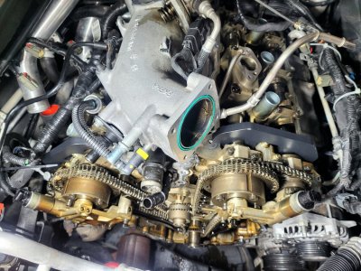

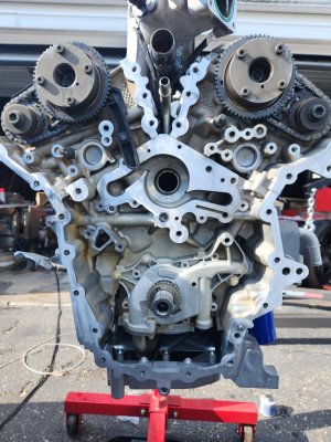

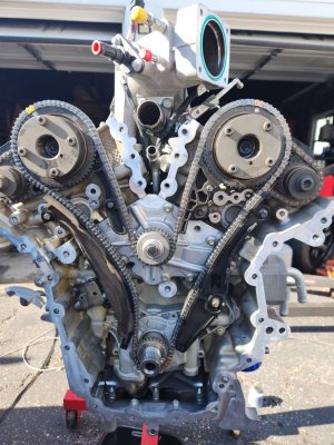

6-7 hrs into it and I'm ready to start replacing parts. It hasn't been bad so far, more time consuming taking wire retainers loose and the cam cover gaskets stuck like glue (probably the worst part so far). Front motor mount to body bolts sucked thanks to Ford loctite. Took a bore scope to things at 125k the intake valves have minimal coking and piston tops are clean. Going to try raising the engine a bit more and see if that helps with the clearance for taking the timing cover on, it was fairly snug coming out and the RTV on the trip back in is a bit of a concern. Tools required other than the cam holders aren't bad.

Keep us updated, Nice work!
what oil have you been using? full synthetic or blend? fair bit of varnish on there.

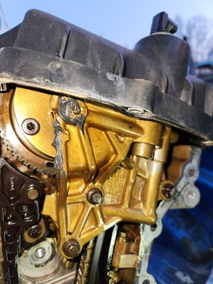

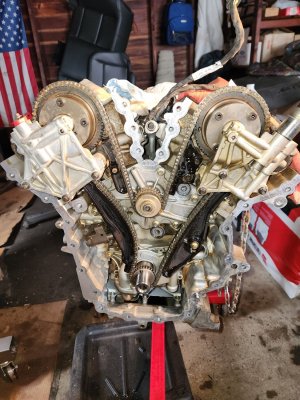

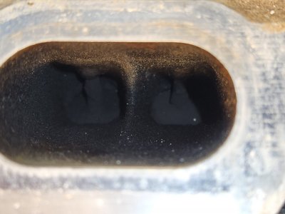

This is an engine we currently have for sale. Picture one is of the exhaust leak in the lower corner, pic 2 cleaned intake tracks, picture 3 lack of burnt on amber coating showing lack of maintenance. Picture 4 the intake tracks prior to cleaning.

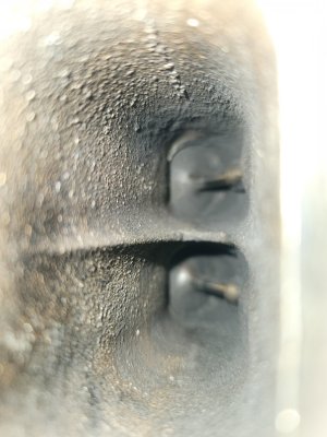

Pictures 5 and 6 if your engine looks like this on the inside I would seriously not put $1000 to $2000 in this engine. Notice the nice clean new water pump. I can tell out that at a minimum this needs phasers, oil pump and oil pan flush, exhaust manifolds and intake track nasty..
Picture number 6 also highlights the problem of installing the timing chain cover in the vehicle. That blob of RTV on the phaser housing is from the 3 circular RTV points around the water pump and timing chain. The procedure requires you to put the timing cover straight on and not sliding it sideways while seating. It's not easy and the result is you blow the engine in a couple thousand miles from clogging the oil pump pickup with the excessive or improperly placed RTV. This is why we pull the pan to examine the pickup..This particular engine, (pictured 5 and 6), is a prime example of throwing money out the window ultimately costing for the timing chain replacement and then a complete engine replacement.
