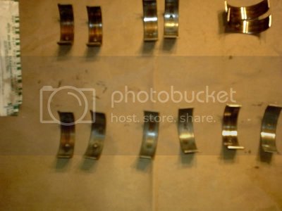

and its starting to sound like a rod knock even tho its not loud as all the rod knocks i heard before.
i checked all the bearings when i took them out.
i didnt get a plastigauge with my rod bearing kit they forgot to include it but the old ones were in spec.
one of the middle bearings was spun but i didnt see any damage to the crankor anything just the little tabs that hold the bearing in place were moved.
the engine didnt knock at all before or tap whatever.
the bearings did need changed as it looked they were about shot showing copper and all.

the noise in the bottom end didnt really start till after the rod bearings.
im gonna post some pics of my old bearings with the measuring stick to show where they stood as far as in spec of not. (i didnt get a plastigauge so..)

theres the bearings... it was hard to get a good shot because the camera is ********.
the ones turned sideways are the ones that spun some on the crank. (never had a problem) i think it happened not long ago before it caused problems. as there was no scratches or anything on the rod, rod cap, or crank. it was completely smooth.
soon as i seen this spun bearing my heart sank. turns out the tabs that hold the bearing in place were flat.
those were the worst, worn bearings.
i found one other set in the middle that had 2 little small chunks outta the bearing.
yet again nothing wrong with the crank, rods, or caps.
i rechecked them all tonight and they are all within spec which i made a mistake before thinking one was out.
but the outside ones i noticed were very little wear.
the engine as it sits has 114k miles on it.
the car never had any maintence from what i could tell when i bought it in New Jersey.
the 3.2 cams actually were missing little spots outta them and the engine was pretty dirty, so tells me this person who owned it really didnt care.
im slowly trying to get this car back to life haha.
ok im making this long.... i ramble sometimes
:edit:
also before i forget the bearings arent paired together i lost the pairs so some arent right. except the ones that spun
