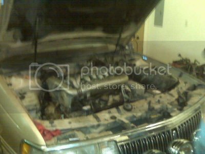

Thanks guys. I think I'll stick with the cables for the time being. Right now I need this car to run and I need to save for the np205 for my pickup I know I'm gonna get ***** on. I want to go back later and trick this rig out, but for the moment the only reason for all of it is because I toasted the 3.8 and picked up the SHO for $500 and the subframes swapped straight acrossed. I'll probably add the rod shifter when I go back through it along with the (re upholstered) taurus seats. For the most part it's fallen together except for the difference in wiring between '89 and '92 and hood clearance. Didn't think about that one until later so I'm gonna have to use a hood scoop or get someone to massage the hood out a bit in the middle.
Heres the only pic I have at the moment. I'll take some more when I have her all the way back together and running. I'm embarrassed of how much of a mess my shop is right now to take more pics. BTW if anyone is in the SW Montana area you should come by and help me with wiring! :naughty:
