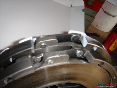

I like the clutchmasters stage 1. The straps and rivets are upgraded. The straps are thicker and wider. The rivets are larger. All pressure plates are valeo. Some like clutchmaster are modified and rebalanced.
Stock in the front CM Stage 1 in the back.
