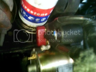

Do the wires on your starter look like this?
Starter 2
There's also that small yellow wire to hook up as well. At least you didn't slip one of the wires inbetween the starter and the block like I did, scared the **** out of me when I tried put the terminal back on the post and nearly welded the two together :scared:
