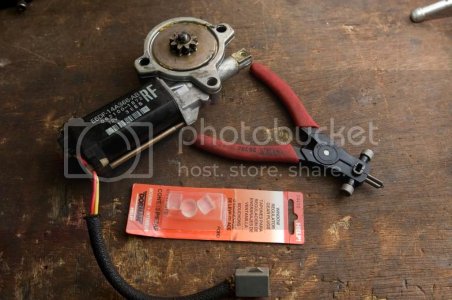

I recently discovered a kit that replaces the plastic bushing which happens to be the sacrificial part of the electric motors. The kit comes with 3 replacement bushings to repair one motor.
Originally I suspected the electric motor to be burned out, and, unfortunately threw away all my damaged electric motors. It is a shame since they are very easy to repair, and as these cars age, it is more difficult to get parts for them.
Anyway, here are some pics showing how to replace them.

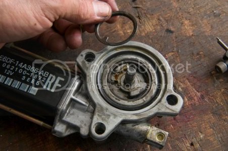

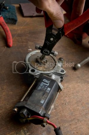

1)Remove the circle clip around the driveshaft, with and expanding remover.

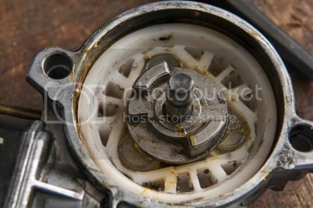

2)Pop out the gear plate assembly and the spring retainer.

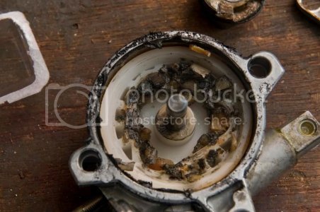

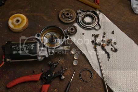

3)Turn the housing around and spread the 2 retaining retaining crimps with a screwdriver and remove the cover plate.
4)You will be able to see the remains of the 3 plastic bushings which will be complete destroyed. Remove the plastic gear housing and clean it well. Lubricate with long lasting bearing grease and install the 3 plastic bushings in the kit. These new bushings will fit very tight, so you will have to jiggle the housing and force it in.
