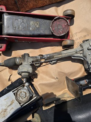

This is my rack and pinion any info I would greatly appreciate please I need this car to get back and forth to work

Doubtful that a 2013 rack would work. The part numbers are different and there is probably a reason for that. There is no cheap solution. Rock Auto has a rack available but, it requires programming. FORScan can probably program the rack. All replacement racks will require programming.
On the slight chance that the belt is the problem, there is a belt kit.
