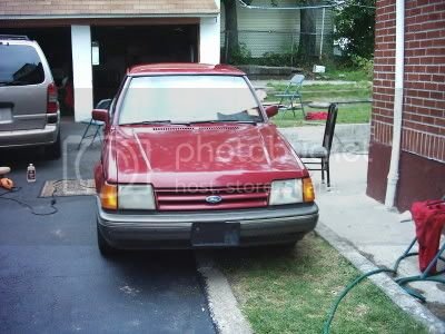

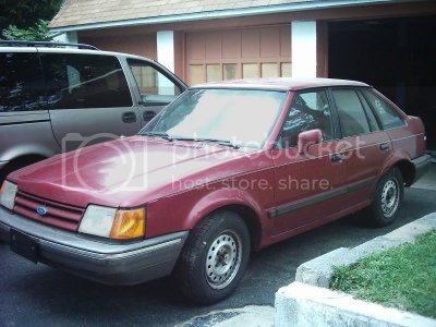

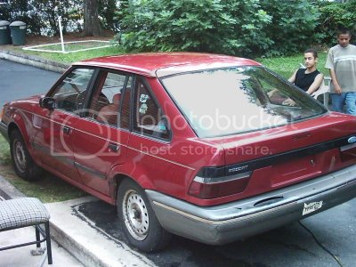

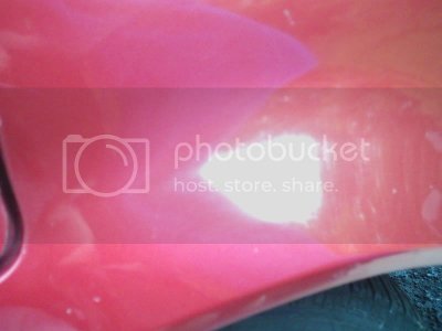

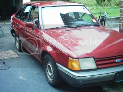

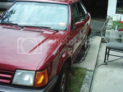

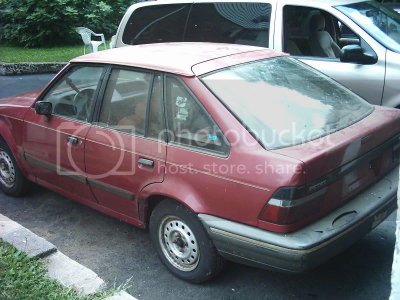

well i had sometime today and well i made a old car look new again too!!! well its no SHO but my friend needs to sell his car so i thought why not make it pretty again! sooo it took me 4.5 hours with rotary buffer to get this aperiance it can probley gloss even more but im too tired today!
Berfores!!

Afters!!!

I think it doesnt look to bad!! any comments would be aperciated!!

Huh??? The car went from an ****** to a SHO with the Mcguiers 3 step??:huh:
Looks good. So when can I bring mine around.:thumb::thumb:
