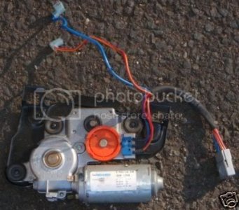

BQ5QgNBmkKGrHgoH C0EjlLlzVpnBJ7PnL9
Looks like there are 3 wires comming in. any idea on which colors i need?
hawkeye18
Sorta cares
May 18, 2004
5,631
2,727
Norfolk, VA
The Blue and Red/Yellow ones. The Red one goes to the limit switch.
Edit: Those look an awful like window motors, which means I bet you can rebuild them like window motors... see my thread in the "How-To" section about those.
You are correct on both counts sir. These motors rarely go bad, usually the tracks need **** and the motor needs cleaned. They are a little more complex though.
You can also push it around as ultimate suggested, I would recommend removing the motor though.
