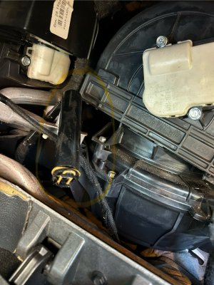

I was changing the cabin air filter this weekend and noticed this item, lightly circled in yellow, just dangling. Does anyone know what this is? I am taking the car to the dealer in about an hour to get a once over and just wanted to know if I should make them aware of this thing.

ok hard to tell for me - there is a piston that keeps the door from slamming open, I know mine was broken by the dealership "guys" during the first years I had them change the oil and air with cabin filter, then I went to change it myself and well the piston was broken and my door just slammed open with no resistance. I bought and replaced the piston myself, however its fragile construction and easy to break if your not careful.
OK, thanks for the info. I will mention it to the mechanic at the dealer. I saw the one of the clips for the panel door for the cabin air filter was broke off already. not an easy one to get to but thankfully it stays on with just one clip.
