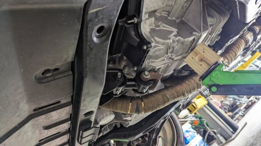

Same thoughts wrap the pipes first, wear gloves, :)
