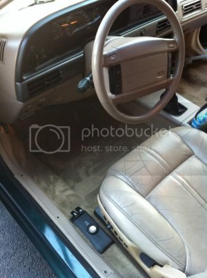

IN doing my own research, here is what I have found:
1. If your seats are shot, Katzkin will be your best bet. The seats SHOULD (i repeat, SHOULD) be the same from Gen 1 to Gen 2...the only difference is the upholstery pattern itself. That said, I have never taken one apart.
2. This is for SHO owners who still have seats in cracked, but good condition: YOU NEED TO FIX THE SEATS NOW, before they get worn out. I have called around to various leather repair places, as my seats are cracked but otherwise intact. The cost to refinish and reinforce the seat from a local Ferrari and Maserati leather tech: $150 a seat.
Call me crazy, but that sounds like an insane deal to me. He will sand down, fill cracks, color match the finish, and then respray the seats.
Here is the man I intend to use, when the time comes:
http://www.technique-leather-repair.com/
Here's what I am working with....he says they are "very restorable, to near 100% condition":

Those seats are not bad at all as far as SHO seats are concerned. Lots are ripped and are missing the foam or the driver's seat as a huge ass-divot in it. I could see the skins being able to easily be restored with no rips in them. My 89's were beyond gone, so I bought sone in good condition with only a few cracks and no tears. At least the seat structure is in great shape and if I decide to go for perfect, I can have the skins touched up a bit.
