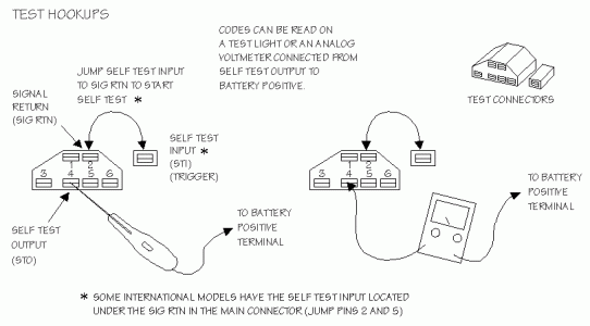

I thought the contacts were messed up (using a paperclip in Feb worked fine) so I put two spade connectors on some 10ga wire and used dielectric grease. Still no change. Yes, I'm going from Ground to the top-left connector.

Not from the "ground" but rather you connect the VIP DLC self-test input (C199, single lead, brown, PCM48) to the signal return line (C198, gray/red signal return reference voltage, PCM46, top right pin when two pins are on top and four on the bottom).
