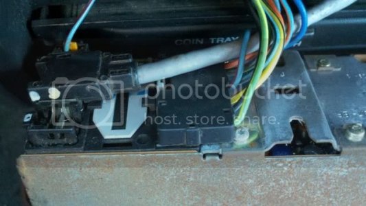

I found the problem. One of the wires to the main plug broke off, grrrr. Thanks for the help errbody......
On a side note: what is this plug for? It looks identical to the plug going to the unit and is just sitting there in a holder.....
It's for the non-premium radio. Side note: If you ever put an aftermarket headunit in use that connector. There is another one like it in there that will give you access to the speakers without having to do anything in the trunk.
