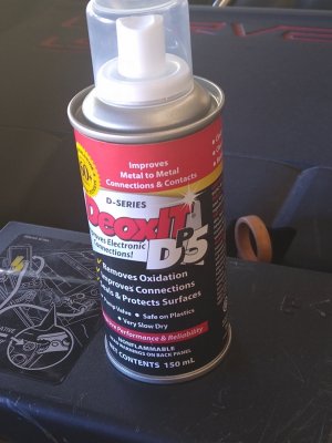

I'd check the connectors in the back of the new radio...sounds like making intermittent connections. Use DeOXIT D5 and spray each connector before reconnecting
