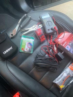

These are the only tools I used to complete the actual hardwire install. The hardwire kit came with the detector as a packaged deal. The rest was straight from Advanced Auto Parts.

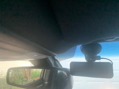

I chose this location because on the left side of the mirror, it impeded too much of my vision when looking ahead.

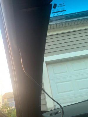

Ran it across the headliner to the driver side windshield pillar.
406f665bf2a8814bbe5a3fa4e797bc27
Ran across the pillar and into the weather strip.

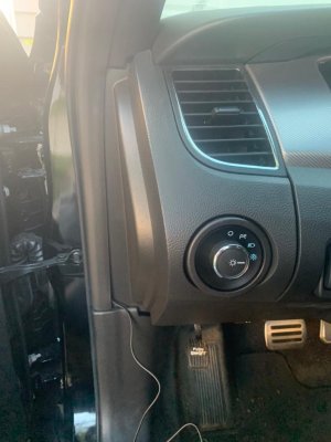

All the way down to the kick plate.
0a6e432479f6e6c033331d3e74e3015f
Into here, this will allow for you to come up and mount the remote wherever you want.
48df6b008ee20eea7aa7ec4f8fa5367b

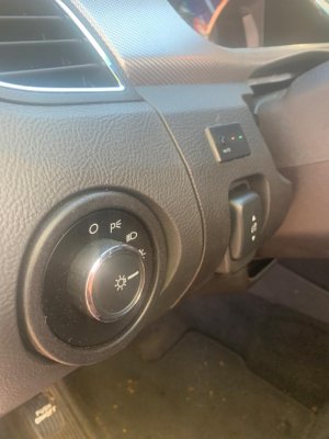

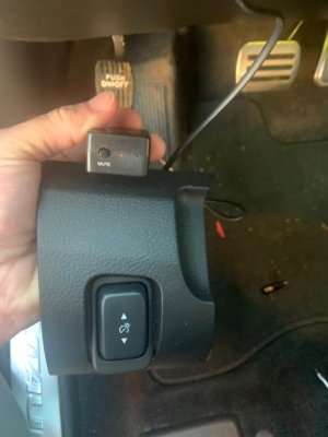

I chose to mount mine here above the dimmer switch. To remove this panel, I used a 7mm socket.
1a6442d93fd374a99c09547fa09f734e

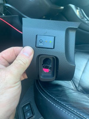

This is the semi-finished “flush” mount. To do this I drilled a couple holes straight through the plastic, used a dremil and air saw (just made it easier) and finished with a large hand file and sandpaper.
Ef71ab773a2edb947689844d55540ac9

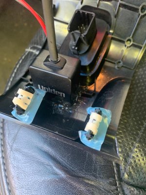

A view from the back, I got the uniden remote as flush as possible and used JB Weld on the back side as pictured. I let it set for 4 hours.

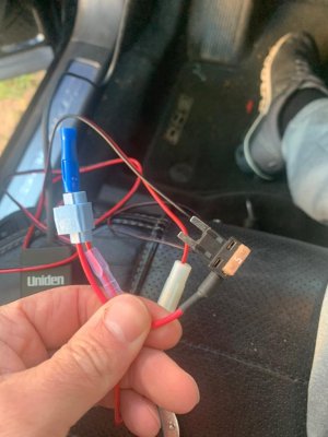

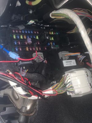

I used a vampire clip (blue) to secure the end of the remote to my add-a-circuit.
09a376e84abdfa397c601dfb100aa096
I plugged this into a 5 fuse and used a 3 fuse for the detector. I just picked one from my user manual that I knew was only powered when the car is on. I tried to use one of the “extra” unused 5 fuse slots but it did not work.
C054d8f0a9907e968bf44669bed4ee1a

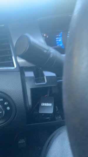

As pictured. I used the bottom left bolt that attaches the plate to the floorboard that runs the starring column through the drive shaft.

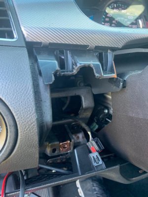

Next I found this clip bracket had to me modified to fit the depth of the remote.
Dc4156286adaca056338093c27bea99e
That worked perfectly. Used a dremil and diamond bit adapter.

Finished product for the remote.

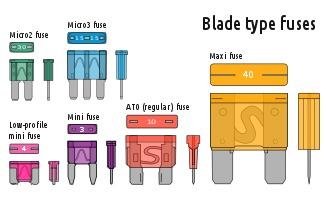

I would like to know more about your fuse tap. I have had no luck with the micro style fuse taps in the interior fuse box. The tall plastic walls between the fuse rows keeps me from setting the tap all the way in.

So the mini fuse tap I used had standard length prongs. When I looked under there I was worried about those walls as well being too high for the tap. However, the fuses that this car uses were low profile making the standard mini fit nicely.

OOH, so you used a standard mini fuse tap in the interior fuse box? That was my problem, I used a low profile mini fuse tap.
Yes, by accident. I didn’t realize they were low profile when I crawled under to look at the fuses. So I bought the regular mini fuse tap and it worked perfectly. Still no issues.
