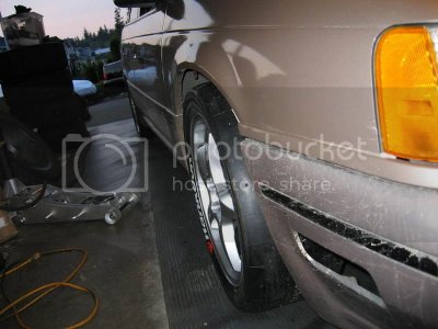

Those are Hankook F200 slicks (C70 compound) on 17x8 rims, ET 38. These slicks are actually 0.1" wider than the 245/40-17 Dot R "wanna-be slick" tire, and 0.3" less in diameter. (Yes, slicks are legal in my SCCA class, C Prepared.) No clearance issues with regard to the GC coilover struts that have the stock spring perches removed. Rear fenders had to be trimmed significantly to clear the tire.

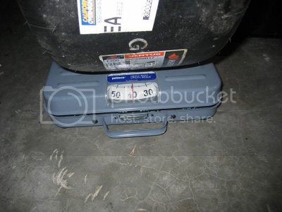

Rim + tire weighs ~39.5 lbs. :naughty:

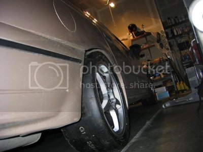

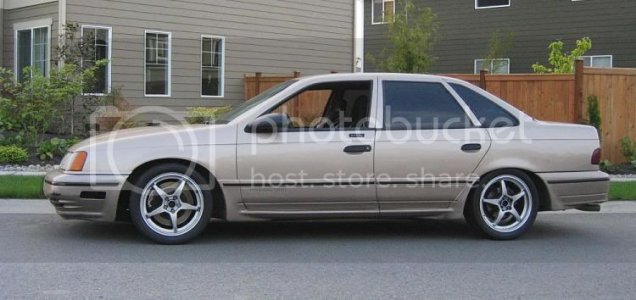

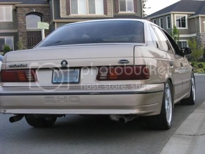

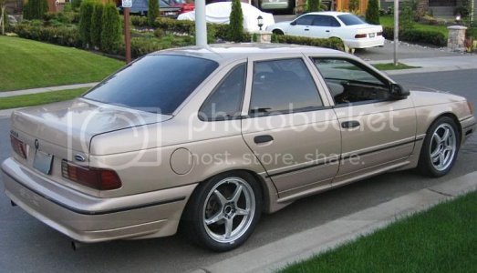

They are 17x8 O.Z. Crono HT. I'll take better pics later when I get the correct centering rings. Didn't want to drive the car out of the garage as they came with the wrong size centering rings. I was just test mounting them to see if they cleared the struts and fenders.
