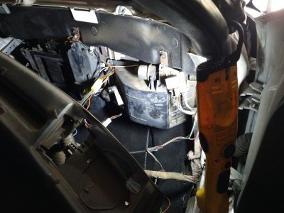

The shop manual calls for removing the dash entirely to replace the heater core, including separating the wiring from between the dash and engine compartment. That's actually not necessary. This is how far the dash has to be pulled out:
IMG 20210512 135328564 1024x768
These instructions will show you the fasteners that would have had to be loosened to get to that point. For a '90, same as a '95:

Good Info above with Nick! Yes it has to be partially at least removed to access it. Is everything 100% back to where it belongs? No way to tell. i have also seen middle dash shaking from bad tire balance/ possible alignment issues. Those are the 2 most common causes with the shakey or squealy/creaky in the dash as far as I remember.

I have seen those fasteners at the windshield area of the dash work loose over the years also. Good chance one or more of those is missing or loose given the dash has been out in the past.
