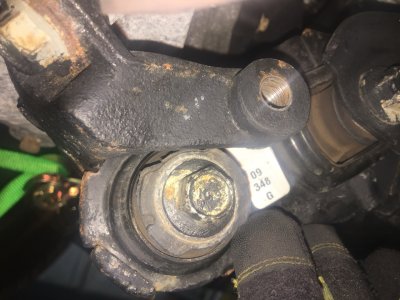

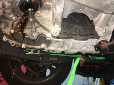

B9a36d8f6c714716d375438a4b69bbe16d5333a4a2a14689e7a68f6a566a2dee
Subframe does not need to be dropped.
The lower dog bone can be removed and the engine can be ratchet strapped enough forward from underneath for plenty of clearance.
Same with the rear turbo.
You can see in the second pic how much the engine rotated. The mount bolt compared to the bracket hole.
