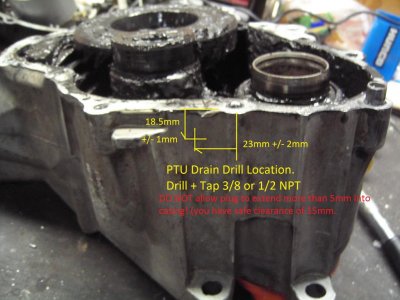

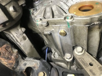

I used the plugs that @Ecoboost_xsport sent to me. Yes they were 1/8 npt thread into the PTU case.
I bought this drill and tap...
I used this picture for location. I didn't used a jig, I just drilled it as straight as possible.

With a sharp drill how long did it take you to drill through the case? I'm thinking it shouldn't take too long. How far from the side of the case did you start the hole? Looks like it might be 1.5 to 1 3/4. Also were you able to get the job done without moving anything out of the way. I was under my car today and it looks like you can go straight up.
Frank
351Blueblood
Jan 5, 2018
42
23
Here the case is 1/2 inch thick. I used 1/4 npt tap no need to go huge size shown on pic.
