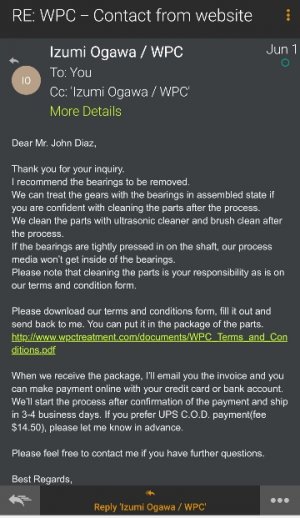

The entire thing was done, bearing and all. I was unable to pull that bearing off without destroying it, so after contacting them, they said they can do roller bearings as well, but prefer to have them removed if possible.

Is that a seal at the bottom of the bearing? If so will it be a problem with wpc?

I'll excerpt the quote from the email they sent me regarding that. You can go ahead...I do have a login over there but finding get there often, I probably should though, lol
EDIT: post of email
