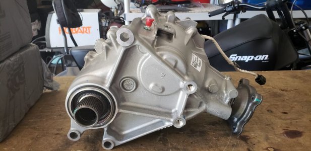

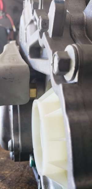

So, this is my attempt at doing what little we can to improve the PTU with what is currently available. I’d also like to make it a resource for those of you looking for detailed photos of the latest version of our PTUs (which has the cooler). I’ve completely torn down the PTU, and sourced all brand-new seals for it. I will keep the photos at max resolution so apologies for their size, but some may find it helpful.
In this photo, looks like the vehicle is beginning to experience some of those dreaded PTU failure symptoms. Last time I was underneath the truck, I saw quite a bit of oil covering the body of the PTU, and soaking the portion of the exhaust that sits underneath it. It hasn’t failed, in that I don’t have any drive-ability issues yet, but it is coming I’m sure. I will say, that I have NOT been proactive with changing of the fluid. Not because I’m lazy but because I was not aware of the PTU issues until very recently. Call it my ignorance on it, but regardless, I’m glad I caught it when I did. It’s a 2015 with just a hair over 30K miles on it. I don’t drive it much, believe it or not, this is pretty much my dedicated project car.
62IJTMfw8gotMwwidth576height1024cropmodenone

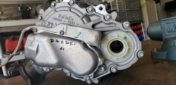

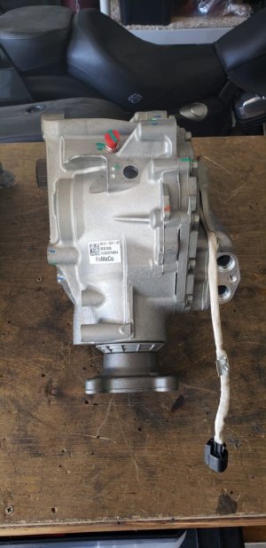

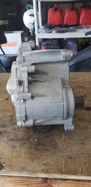

Anyway, being the consummate prepper that I am, and wanting to keep downtime to a minimum, I went and purchased a brand new one before I am even taking the old one out.
Ford Part Number: DG1Z-7251-F

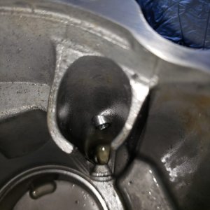

My punch list for things I want to accomplish with this:

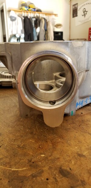

  • Change drain plug to bottom of case in order to ensure complete drainage of fluid when performing oil changes.
  • Extend hose from vent to top of engine bay to facilitate future oil changes and fills.
  • Send all gears and cast components to receive WPC treatment (WPC Treatment).
  • Send all gears, cast components, bearings and case to receive cryogenic treatment (Nitrofreeze).
  • If possible, research possible higher quality bearings to replace existing ones.
  • Apply gold metallic radiant heat reflection material to outside of case.

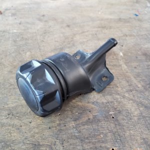

Now I want to say, I truly believe if you have an older SHO/Flex/XSport that doesn’t have this cooler, you COULD make this version with the cooler work. It would take some effort, but I am certain it could be accomplished. You’d have to buy the hose:
Ford Part Number: BB5Z-8A519-G
LJ8rrPNsv7peQHwidth1024height592cropmodenone
Then run your lines through an aftermarket pump and heat exchanger of some sort. It would be a pretty trick setup if done right.

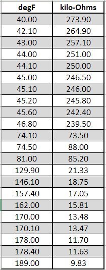

And for those of you wanting to do just that and get REALLY fancy by using the included temperature probe to wire up to the pump or some sort of temp gauge, I think I did some of the legwork for you on giving you some data on the output of that probe and how it correlates to temperature. I figured since I have it off and I have the tools to do this, I’d pass this onto you guys. What I did was use two of my Fluke meters, using one that has temp reading capability with a probe end right next to the actual probe itself, and use the other meter to read the resistance output of the probe at various temperatures. I created those various temps using ice water then boiled water. Dipping the end of the probe into the liquids and taking temp recordings at various intervals. Here is a simple spreadsheet showing the results. This may help those interested in the scaling of this particular temp sending unit:
YzxjzPl6DpaJr3dwidth210height535cropmodenone

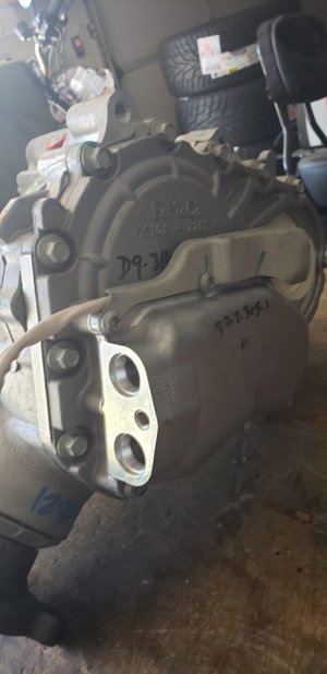

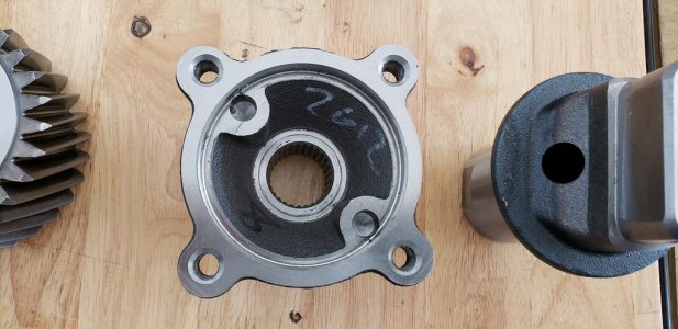

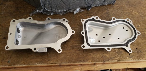

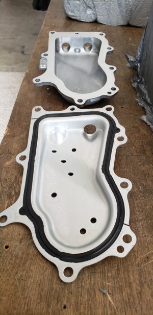

As I disassembled it, here is what the cooler actually looks like. It isn’t very complex, I wonder if there is any way to improve it:

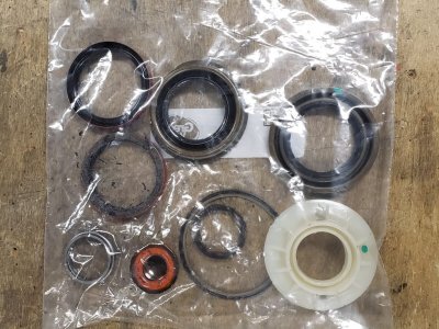

So, before I started complete disassembly, I ordered a replacement for every single seal, gasket or one-time-use part as I wasn’t sure how much I would destroy trying to take them apart. Below is a list of all the Ford Part Numbers you will need as far as seals or seal kits go:
  • 7T4Z-7086-A (Qty: 1)
  • 7E5Z-7H469-C (Qty: 2)
  • DB5Z-7275-E (Qty: 1)
  • GB5Z-7275-A (Qty: 1)
  • 7T4Z-7R284-A (Qty: 1)
This does NOT include replacement of the cooler medium. The edges of it are rubber, but it was in good shape and I couldn’t find the part number anyway.
Here’s a bag of all the old seals after being removed. The stuff in this bag will be thrown away, but not until it’s all done, LOL:

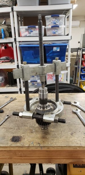

When you take it apart, make sure you have some sort of catch for the oil that will come out, as it comes filled from Ford. I have a large oil drip cookie sheet that I was working on. Worked great! BTW, I forgot how much I hate the smell of gear oil…
When you finally get it apart, you will find it somewhat difficult to remove the gears from the side of the case. In order to remove them, you will have to basically destroy the white end seal/plastic cover that is pressed onto the end of one of the gears. Make sure you get a new one, but once you do, don’t be afraid to just break it, it’s hard plastic. Once it is off, the gears will all come out one after the other.
N920jzKb3tYOFdwidth498height1024cropmodenone
WKs2k0PMkcIoSpwidth498height1024cropmodenone
I just used an air impact to remove the nut off the end of the pinion gear. That nut will be replaced and is included in the new parts kits. Be advised, many of the seals will have to be destroyed when removing them.

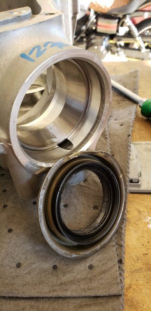

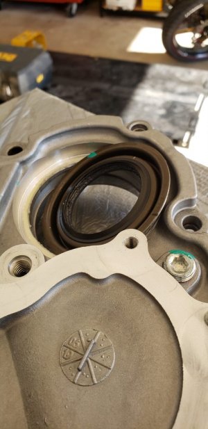

I decided to remove all the seals as I wasn’t sure if my disassembly would damage them at all and, more importantly, they may not survive the cryo process. So, when I send all the parts to cryo, they will be disassembled bare metal.

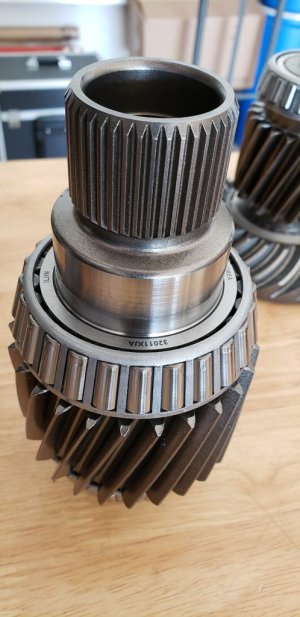

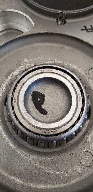

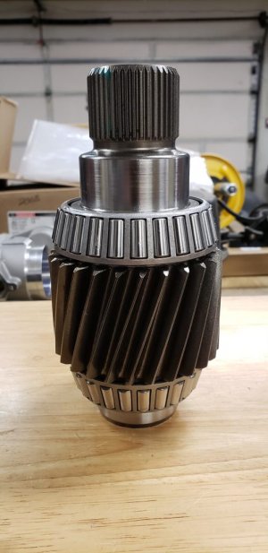

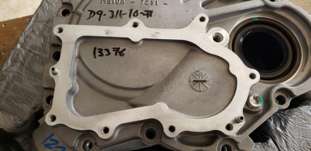

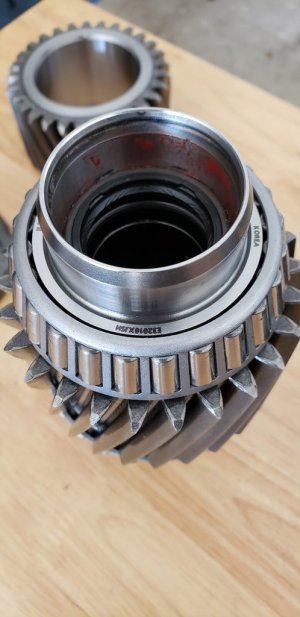

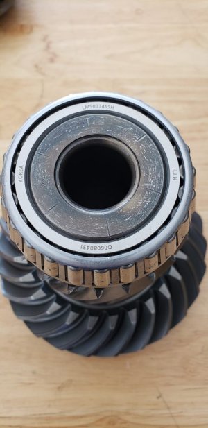

As for the bearings. My goal is to try and source some higher quality ones, if they exist. I imagine Ford made some specifications for bearings they needed, then sent out the contract for the lowest bidder to meet those specs. Most of the bearings are Iljin, whom I’ve never heard of, but looks to be a Korean company. I’ve found some in-depth documentation on some of their bearings but so far, nothing about the ones within the PTU specifically. I’m hoping to find some equivalent or better versions via Timkin or Torrington, maybe some SKFs. I removed as many of the bearings as I could:
8E5QJyEZ6qK adwidth498height1024cropmodenone
The only one I cannot remove was the one behind the pinion gear head. It sits in a recessed pocket and no puller can get behind it without destroying the bearing cage. Even though I will begin the process of looking for better grade bearings, I didn’t want to risk destroying this one as it may end up being a unicorn bearing and not easily sourced/replaced.
ASSISTANCE FROM FORUM MEMBERS: If anybody has an old PTU that they replaced laying around and can take it apart and either send me the pinion gear with the bearing on it or feels like removing it (even if it’s destroyed) and tell me what the part number is, I can better research it. For some reason, of all the bearings in this PTU, the parts numbers are not showing on the visible end. I think they are on the backside.
9ACQWsVLFBdXWxwidth498height1024cropmodenone
ASSISTANCE FROM FORUM MEMBERS: Although I have some good resources for locating bearings, I am always open to “crowd-sourcing” this task. If any of you guys have a good bearing “guy”, here are some of the bearing numbers:

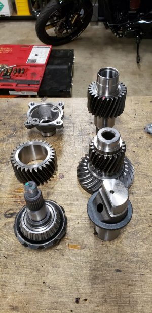

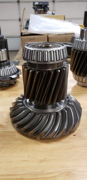

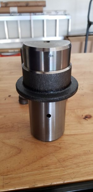

Anyway, here are all the parts I’ll be sending to WPC:
OPyCBeDL9itiL width498height1024cropmodenone
I spoke with one of their reps regarding having parts with bearings still pressed onto shafts. Their response was, although they recommend removal of all roller/ball bearings, they CAN still apply the WPC treatment, but it is absolutely imperative that a very extensive and thorough cleaning job be accomplished on the bearing prior to installation. They do ultrasonic cleaning, so it should be pretty good, but I also have a high-quality industrial grade parts washer I will put all the parts through as well once they come back.
The cryo treatment will be performed after the WPC treatment and I will include every metal component I can for that one. It will be sent over un-assembled except I will re-press all the bearings back onto their respective location. I use a bearing heater prior to pressing them on (it gets pretty damn hot) and don’t want that to cancel out any gain provided by the cryo treatment in doing so. I will do final assembly and seal installation after it all comes back home. There is no case gasket but looks like they used something similar to Yamabond, which I’ve used successfully to seal Harley Davidson Twin Cam cases. It should work fine in this instance as well. Then fill it with some Amsoil Severe Gear Oil:

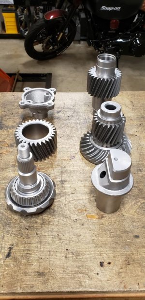

UPDATE 01: Internals back from WPC. Now to press the bearings back on and off to cryo...

Bearing...try looking at Timken LM503349A/ LM503349A-LM....Bore45.99mm, OD 74.98mm, T-Size 18.0mm

Yeah, I was looking at how much material that cooler body has on it and was entertaining the idea of machining that itself. Not sure its feasible though. Its possible to do your idea as well. As for PTU temp, it's already being monitored via the PCM as it has a temp sending unit. It's one of the gauges I have displayed on my torque app.
Edit: well the body of the cooler is irregular and curved so would be difficult to simply machine a flat surface...BUT...follow me here. It's easy to create a 3D scan of the cooler cover and have one 3D printed to use as a mold for an aftermarket one or use the scan data as data for a CNC machined one that can have cooling fins incorporated...this is something I may actually entertain. Need to find a good CNC shop that can map the existing cover and create a finned one...hmmmm.
