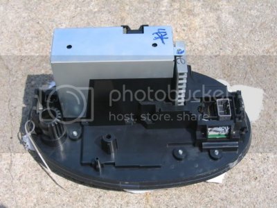

The 98-99's only have one large plug instead of two
Here's the one I sold on ebay in May I believe... The buyer said it was from a 96, I had no idea. It only has two plugs though :shrug: He said it worked in his car so I took his word for it.

When I said three plugs for the early models I included the one for the rear defrost too.
