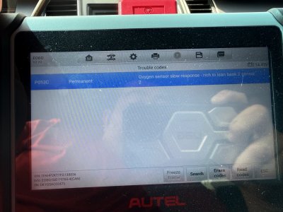

Hello All,
2015 PP here... p013c shows on scanner as permanent code. No CEL is on. But I have 3 "not ready" going on about 6 months now.
02 Sensor, Heater, catalyst all not ready.
My bank 2 sensors (1 and 2) show low voltage but do slightly fluctuate. LTFT on bank 1 is about 24 and bank 2 is 17. Bank 1 voltage is normal on both sensors.
I replaced both downstream 02s thinking that would help (before I got the scanner), nothing changed. I have also replaced plugs for basic maintenance during this period and no change.
I have done drive cycles and more drive cycles on top of drive cycles.
Any recommendations, advice, and help would be appreciated. Thank you!!!

The "permanent" codes will stay until the pcm sees that the problem has been gone for a certain number of key cycles and possibly a certain number of miles, so unless you have driven it for multiple weeks after the repair, it is likely still going through the 'prove out' portion before it removes that code.

But the bad readings on the scanner would still remain? It’s been 3 months since I replaced 02s with the car starting every other day and drive cycles done as well

What do you consider drive cycles? There is a specific procedure to the drive cycle for each component.

I did Ford generic, did 2015 Taurus specific. Multiple ways on both. Probably around 15 times. Mostly late or overnight so I didn’t have to worry about traffic. Evap and other things that usually take a long time to ready were done almost immediately after the first time

Yes, the 'bad' reading will continue to show on the scanner until the pcm proves that the problem is gone. However, if it has been 3 months of regular driving, that suggests that the code is reappearing from time to time so that the pcm never proves that it is gone. There may be a wiring issue or bad connector such that it usually is fine but not always. Those kinds of things are the hardest to find and fix...

How does the car drive, as in any noticeable issues?
Any tuning, aftermarket parts or exhaust?
Here is an overview of the DTC P013C from the PCED manual.
Your long term fuel trims are definitely on the higher side of lean.
The monitors not completing are a concern.
You can reset the KAM and re-evaluate for any concerns that return. Permanent DTCs are eventually cleared over time of successive drive cycles with no issues.
Notice what is says about the code being very sensitive to exhaust leaks, even very small ones.

It drives fine… it is tuned for going on 6 years now. Catted downpipes added about 3yrs ago. No issues. This is out of the blue. It does seem like it eats a little more fuel than normal but not substantial. I’ll check for exhaust leaks. And again not throwing any codes but I do need to get through inspection… one way or the other… eventually.

I have had exhaust manifold cat leaks for this DTC on other Ford platforms. Ford would tell us to smoke the exhaust for any leaks, even small leaks on welds.
The UEGOS Universal Exhaust Gas Oxygen Sensors (upstream) are very sensitive and quick at responding to upstream fuel changes, rich/lean.
The Catalyst Efficiency sensors (downstream) monitor to effective of the catalytic converters.
Based on the permanent DTC it's relating to what the Bank 2 , left side of the engine as oriented from the rear of the engine looking forward, is seeing. It doesn't usually mean the sensor is defective, but more that it's seeing something it doesn't expect within the parameters/calibration based on engine and outside ambient temps, load, TP, APP, gear, FLI, etc.
When the monitors are run, there are various criteria that must be seen in order for it to complete. Sometimes it will keep trying each drive cycle, but again there are clearly defined parameters for it to test and complete or fail based on federal emissions standards.
Can you supply a VIN so I can search a little deeper?

Thanks on the VIN.
I just wanted to search Ford's database with your VIN for any knowns with that DTC. None were found.
I believe you replaced the UEGO sensors?
OEM or after market?
If you smoke test the exhaust system for any leaks, that would be the first direction, if there's nothing obvious leaking. You can also create back pressure on the exhaust and see if you hear any exhaust leaks.
Otherwise, I would reset KAM, clear any and all DTCS.
Since you have a scan tool, I would monitor and record multiple PIDS of the PCM to see what's occurring.
Short and Long Fuel Trims, CHT, FLP ACT, FLP DES, FRP ACT FRP DES, RPM, GEAR, both banks 1 and 2 OXYGEN and Catalyst sensors and check at idle and higher RPMS.

Thank you for this info and advice. I will start with the smoke test and go from there.
Will update once I find the problem. Hopefully, sooner than later.
