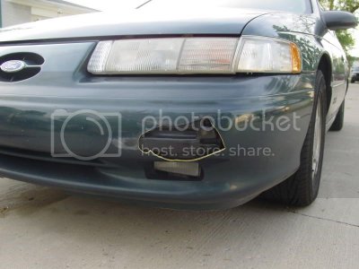

So thanks to some kind west side folk here in MI, I have a bumper cover sans-hole. This is what the old one looked like:
DSC02029
For starters, the paint on my new (used) cover is absolutely shot, so it needs a repaint. Looks to be a mix of flaking clear coat, a few layers of rattle can, and portions that have nothing sticking to it at all (just yellow plastic).
I can probably get a decent deal from my neighbor to have it painted, but I'd like to do as much prep work as I can. How would I go about doing that? Just get some heavy grit sand paper and go at it?
Also, the new cover has a small crack near the bottom that looks like it could be repaired. I've read a little bit on repairing plastic bumper covers but it's something I've never done before. Anyone have any experience in repairing bumpers? I believe ours are made of urethane if that means anything.
