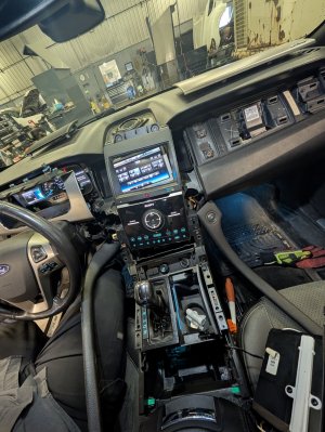

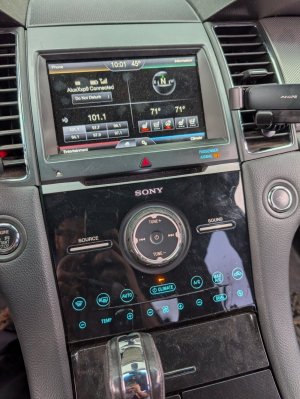

Got the on/off button going crazy, HVAC cycles on/off sometimes pretty rapidly. You have to use the actual touch screen as the lower controls are deemed useless during this. But doest matter it'll shut right off/on anyway as the actual touch button is being triggered.
Concussive therapy used to reset it and it would be great for a week, but I can't risk breaking my hand again, the last time I hit it I was seeing stars I hit the ****** so hard.
I'm assuming there are just a bunch of touch sensors behind the plastic screen, or maybe there is lint/debris that's bridging the gap and causing false senses/touches.
Has anyone split this unit apart to see what the guys look like?
OE replacement is $500 and the aftermarket full touchscreen won't allow for hvac use with remote start.

I took the FCIM apart on my 2013 MKS EcoBoost. There are multiple capacitive touch ICs on the flex board behind the buttons, but the part marking and pinout did not result in me being able to identify a drop-in replacement options. I did save my faulty FCIM in the hopes that either I'd come across another one to get one working or be able to part out the working ICs to get another one working.
-Rod
