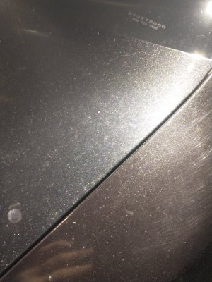

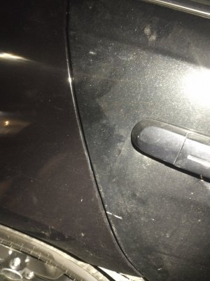

Thank you for all the replies. It seems the door is the right color and that side of the car has been repainted. Never noticed it before. So I guess I need to do the whole side of the car. This project is getting a little worse all the time. The door to fender and trunk to fender are the pics. The other side of the car is fine.

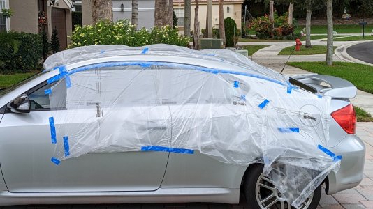

Yeah prepping is a big part to avoid over spray
