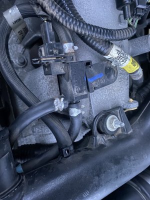

Is it a miss fire or a boost dump? Check the zip tied hose, if that isn't the issue then check all piping for leaks.
