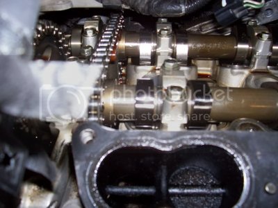

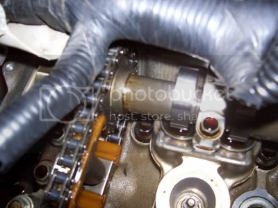

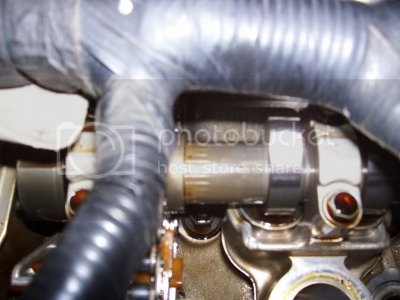

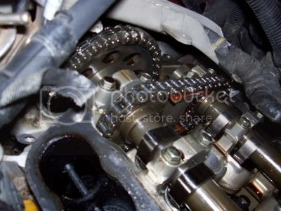

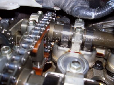

It all started when I sourced an oil leak to the rear valve cover. Well today I finally had a chance to start tearing into it and I figured the intake needs a good cleaning too since I’d never done it. So that was the plan. I had no problem getting everything off meaning the surge tank and all. This was because whoever supposedly pinned the cams left out the bolts they obviously could not get back on. Well once I got the valve covers off I thought something seemed strange. I knew the cams weren’t welded, but the previous owner said he had them pinned, and I’m not sure what that is supposed to look like but I noticed nothing done to them that I could tell. However I did noticed marks near the sprocket which you can see in the pictures. Now I’m not sure if this was from when the previous owner had it or not but it has me worried. Here are the pics.
Intake side front bank.

Exhaust side front bank.

Intake side rear bank.

Exhaust side rear bank.

Another rear bank shot.

The three without the bolt object on them had the grooves in them. I’m assuming this is bad. So looking at this I’m assuming I need to get this thing welded so I need to find a place close to Ohio to get them welded.

Thats kind of what I thought it should look like and I'm pretty sure none of them looked like that unless all four of them were turned down towards the block which I highly doubt they are. I'm off to look again.
EDIT:
I just went out to check and they are absolutely not pinned. I guess the guy I bought it off of got screwed and in turn I was screwed as well. So basically the past three years I've been driving this unwelded car all over the place. I guess I've been pretty lucky. So I guess I might as well start asking. Anybody know a place in Ohio or Southern Michigan where I can get cams welded?

Those scrape marks are from when the sprocket was installed and no problem. The scribe marks are the factory serial numbers for the cams if you are talking about a number scratched into them.
Well that is good to hear. Knock on wood at least I should be able to drive to get them welded. Now I'm probably screwed!

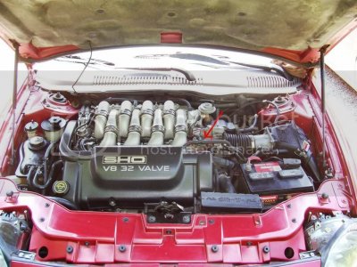

One more thing. Does anybody know what the plastic "T" piece is I have circled in this picture? I managed to break this. Now I need to find another one.
TPiece
SHOZ123
Dec 2, 2000
12,152
673
Illinois
That tee is for the PCV fresh air makeup. Any 3/8" plastic tee will work.
