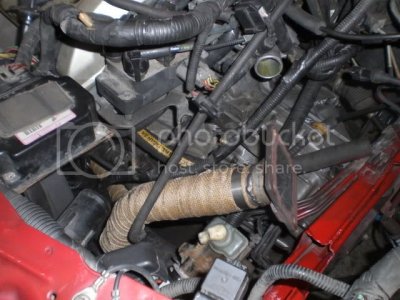

Do you guys plan on welding some reinforcement to that part of the unibody? That part is structural in nature.
No we don't. It will be fine with just that little bit that we cut out. Without notching that, we wouldn't have been able to fit that huge turbo in there. The oil return line was hittig the frame rail.
I can see what you mean, however, neither of the turbos we have done before (well actually the three before this) have had any done. there haven't been any problems that we have been able to see or any that we have come across and i don't think that we will in the future, but thanks for throwing that out there, it may be a possibility if it is what he wants to do. :)

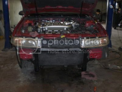

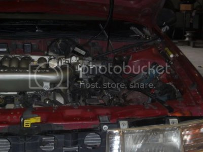

here are the latest. intercooler on...check, oil lines on...check... intake manifold on...check....
intake and turbo on the car
CIMG0585

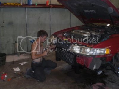

johnathon tightening some bolts for the front mount. yeah it is freaking hot out.
CIMG0590
Front mount and intake/turbo mounted pic
CIMG0584
alright, there is what is done so far on day two at 5:07 PM

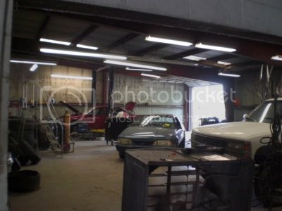

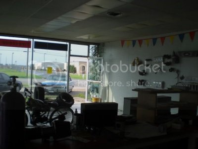

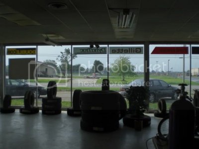

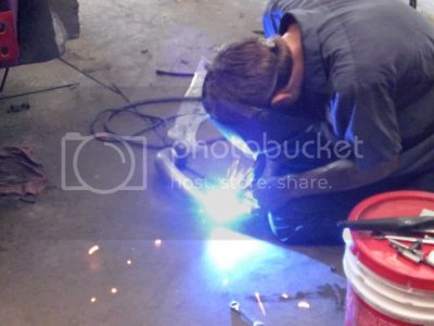

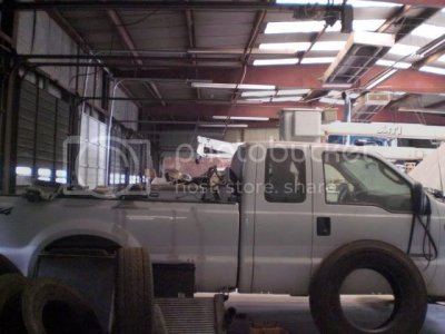

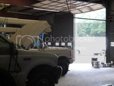

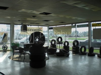

okay, for the guy that asked about the shop I am going to put some photos giving a little idea of what the shop looks like here (a vague idea...it is raining outside so I don't wanna go out there to take pics). but first:

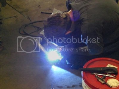

welding the piping from the intercooler to the turbo
CIMG0592
more welding of the intercooler piping
CIMG0593
and for the shop:
CIMG0594
CIMG0595
CIMG0596
CIMG0597
CIMG0599
CIMG0598
not the whole shop or even the body shop we have in back, but just to give you an idea of where we are working.

wow, that is a big shop. Does anyoe know where I can get a turbo kit to bolt right up for my sho? I really want one lol.e

The only thing I am concerned with would be how it would respond in an impact. It should not present a problem otherwise. Boxing that section up should take car of that though.
BTW, do you guys put a flex-pipe in your DP, or on the catback? With the turbo hard-mounted to the engine, does it have some room to move? I have always used some seriously stiffened mounts, so the engine does not move a lot, but the flex-pipe at the front of the catback helps with any little movement that it does have. If you are not using one, you might consider it.

We are using flex pipe. We don't really see a problem with the cutout in the frame since it is far enough in front of the strut. We consulted our friends at the Ford auto body shop and they said that notching that little bit out wouldn't interfere with the strutural stability of the frame. And if I wrecked I will probably be going fast enough that it isn't going to matter anyways.

yep we did talk to ford first, and they said since it is in front of the struts that will not affect it, you are correct my friend :)
