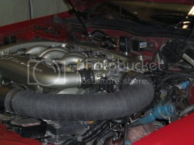

All of the piping for the turbo and oil lines is complete. Now we are going to put in the 255lpm fuel pump. I didn't think about it and filled up 50 miles before getting here. So it should be quite fun. I'll keep you updated as stuff moves on. We are going to do a 3 inch downpipe instead of a 2.5. That should help alittle and let the turbo spool faster.

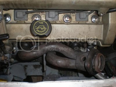

I would have to agree, I changed out the manifold I made for a header, didn't feel any noticable difference, although I do feel happy with the header.
