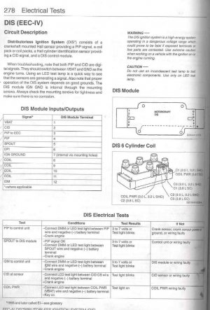

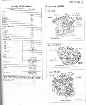

Does sound like it may be the Camshaft (CID) Sensor. Run the Probst DIS tests.
