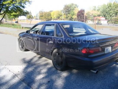

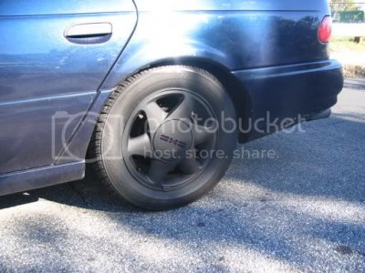

[/IMG]
[/IMG]
This is my old 94 mtx. I used duplicolor gunmetal. 1 can of gunmetal, 1 can of clear. Came out awsome for less than 15 dollars. Man I miss that car.
The only thing that sucks is taking the centercaps off. Even if you use a rag its very hard to prevent it from chipping

Now was this a rattlecan you guys used? A spray gun is out of the question really. Plus, anyone got any pics of a white gen 2 with black slicers? and mr. cash, when you say light sand the primer, do you mean with a Real fine grit sandpaper? Those wheels look great btw. Thanks!

Yea after I prime I use 600 grit just to break the rough surface of the primer.

Sweet, I'll have to pick up some supplies tonight, Duplicolor Gunmetal, a clear coat, and Sand paper. Would Autozone, Pep boys , etc carry this? The paint that is, and will one can really last all 4 wheels? Im guessing that depends how many coats you put on it, How many did you use on your Red car? Thanks guys!

one can will do all four, but its alittle close...
i would buy 2 just to be safe...
pep boys has it as well.
