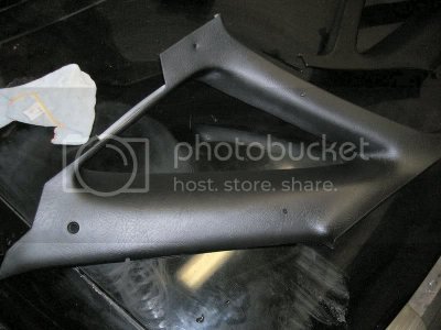

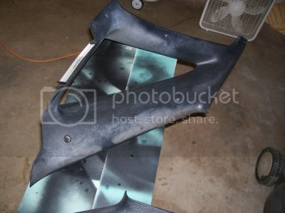

VHT is good, SEM works pretty well as well. Honestly for how much time you are going to spend taping and prepping the thing, you could have done the dash swap. However, if you dye/paint PREP THE SURFACES! I use SEM products regularly and they have a cleaner/prep-spray to be used after scuffing/stripping, then an adhesion promoter, then a color coat, then a clear top coat. I have used their system many times with good results!
Before:
Resto01058
After:
Resto01059

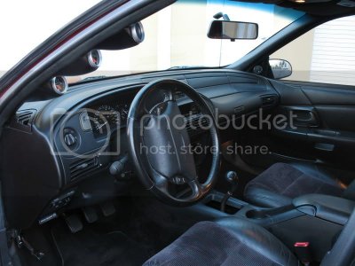

I dyed my dash with VHT dye. I already had the dash pulled for a BDA fix, so there wasn't a whole lot of masking. I also used an adhesion promotor before the dye. IMO the dyed dash looks better than the factory black dash in my 93 and it has held up great. I took some pictures the other day, I'll try to get them up tomorrow.
K-Dawg
Mar 5, 2003
6,063
1,333
Treasure Coast, FL
Here's the dash dyed with VHT. The can that I used on the passenger airbag was junk so I need to redo it, but the rest came out great. You'd never know it wasn't original.
