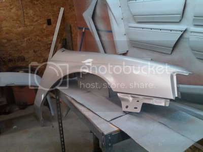

So I sprayed a coat of epoxy on everything and followed it up with a coat of surfacer. I block sanded that out and scuffed out all the rough spots near the edges/seams.
There are still quite a few spots that I "can find", but overall, it's looking pretty good, I think.

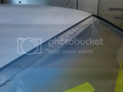

So I was "feeling up" my roof and just didn't like knowing there was hail damage. It's been bugging me so I glazed the roof and here's what I got :eek:
More epoxy and surfacer...

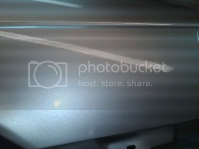

Said to heck with it today and spent several hours stripping the urethane off of the windshield lip. I recoated it with PPG epoxy primer and it came out great. Now there's a nice clean lip for the glass guy to put his goop on.
