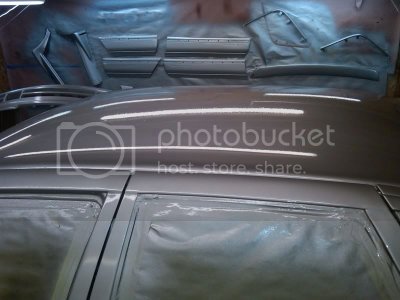

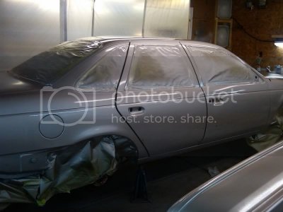

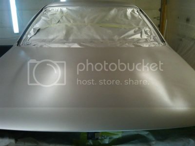

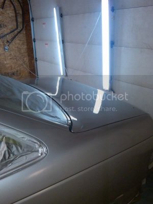

That's after one coat of clear...two in spots.
I had to give up having only sprayed half a gallon of my 2 gallons of clear. Too many f'in bugs. I got done with the base coat just in time, because there were ZERO bugs in that. I'll have to let it cure for a while before wetsanding and going for coats 2 and 3+.
I'll probably reinstall the bumpers and rocker covers, and loosely install the door cladding before I finish. We'll have to see.

Drooling on the keyboard. That's fantastic - it'll look great.
OCD is a good thing!
Very nice home paint booth too.
Great thread... thanks for posting the process.

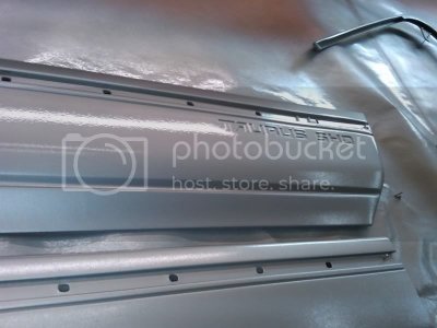

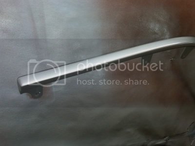

Great news...I'm awaiting confirmation but it looks like I won't need to sand out and re-apply clear to the bumper covers and cladding. Since they were on the wall, they didn't get bugs in the clear and I'm told that they'll match the rest of the car just fine - as is. This will save oodles of time and eliminate the need for me to spray any more color.
One more coat of clear on the body and It's reassembly time. :woohoo:
