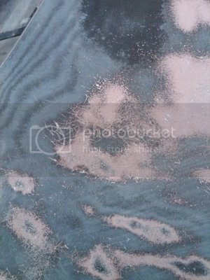

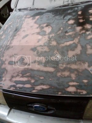

Here's some pics of the hood sanding
IMG00091 20110430 2217
IMG00090 20110430 2217

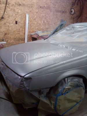

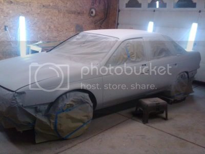

And where I am now.
IMG00130 20110529 1644

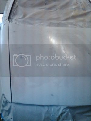

As you can see in the following picture, Bill know's how to take out a fairly good sized ding. He hammered on it for about an hour, spread a bit of bondo, sanded. All I did was spray an extra coat of surfacer on that quater panel...all that was left was a TINY high spot on the character line
Unrepairedquarter

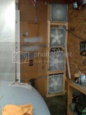

are the fans pulling air or pushing to the paint booth ,will be doing this on my blue 93 shortly and trying to figure on the best way to set up

They're pushing and 2 of them are stacked two deep...so six fans pushing. I'll have the garage door open 20 inches and I'll have 3 fans exhausting air out when it comes time to shoot topcoats. So, there will be a total of nine 0.8 Amp fans cycling air. Hardly enough to call it a "draft" booth, but it cleared the room pretty well when I shot the primers and I didn't have any fans pulling. The intake fans all have furnace filters and these types of fans don't like to make pressure so I think 3 exhaust fans and 6 intake fans should almost balance the rooms while hopefully, maintaining a slight positive pressure.
As I go along, I'm improving my little paint booth. I still need to "dexter" the ceiling and duct tape the cement to the walls so I can spray the floor with water and squeegee it off without getting my garage walls wet. I'm not too sure about that server box door, either.
paint booths should always be positive pressure so that your not sucking crap into the booth. The only air you want in the booth is air that has been drawn through the intake filters

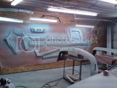

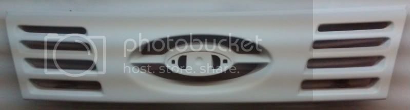

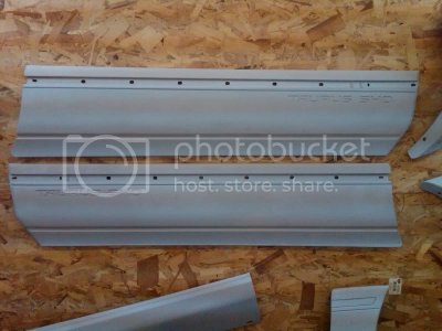

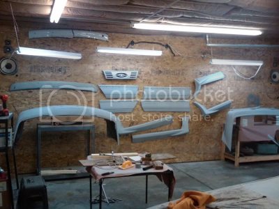

Did this yesterday morning but phone died and I had to run out. Everything but the front bumper cover is ready for scuff/seal/color/clear.
IMG00138 20110605 1202
IMG00139 20110605 1203 1 1
IMG00140 20110605 1203

the one thing i would do is the way you have the rear dog legs hanging i would hang them like they were on the car, you could even hang all of the skirting like it was installed that way you will get a even color coat for each side, just my 2 cent's ....

I'll be doing that. For surfacer, though, this just makes it easy. What I'll be doing is applying the sealer and first coat or two of color on the wall, and then put the car up on jack stands and lay the parts directly under their final destinations to be finished.
I've also got everything hung so that their edges aren't touching the paper.

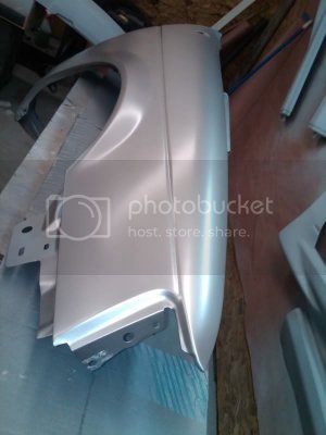

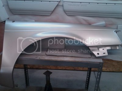

Since Bill keeps mentioning how difficult it is to spray silver metallic, I dug my brand new passenger fender out of the attic and gave it a scuff. Then came epoxy and then surfacer. After sanding out the surfacer, I applied a reduced by 10% acetone coat of epoxy as a sealer. I was instructed by the paint store that this is not only a common, but the preferred method of applying sealer- especially in michigan...and ESPECIALLY with base/clear. Good enough for me.
Fresh out of the box fender:
IMG00142 20110611 1049
Just as the basecoat is about all flashed off
IMG00143 20110611 1447
IMG00144 20110611 1448
I'm going to allow it to continue flashing for a couple of hours before clearing it.
