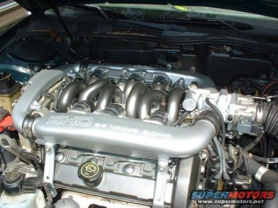

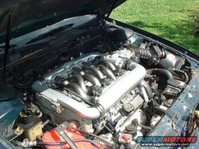

Just did mine a couple weeks ago and I must say that I am amazed at the results. I used a combination of Duplicolor Aluminum-colored Engine Enamel and their gunmetal wheel paint along with a couple of light sprays of clear. All I did was scuff with scotchbrite, and clean well, wiped with a tack cloth, and sprayed. Just look at the results:
Getfilephpid119462togglefullsizefDSCF0053
Getfilephpid119458togglefullsizefDSCF0049
I'm happy, and it only cost me about 20 bucks in paint and supplies.
Good luck,
Paul
