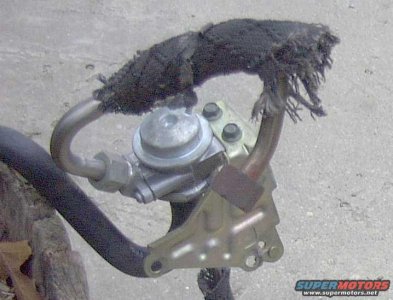

The hose leaves the pump and travels along the subframe to the rear side of the motor. Then comes up to the air diverter solenoid under the surge tank on the drivers side. It then branches off to the metal tubes that pump the air into both exhaust manifolds.
Sai diverter valve and bracket
Sai plumbing

Hi Paul, Thanks for that great pic... I have a P1413 code, aux emission Should I replace this diverter soleniod? Do you have that piece for sale?
Or is it the relay? Thanks

I second the thanks for the fantastic pictures! It looks like the diverter is vacuum powered from what I can see. Is there also a wiring connector on it? I'm wondering if the vacuum line might be deficient or loose, or if the rubber hose is loose for that matter.
One of my next steps is going to be pulling the exhaust line off the pump to see if it is actually blowing air with enough force. That should either pinpoint or excuse it from being the issue.

The diverter is vacuum powered and that is what the solenoid does, switches the vacuum on and off. It has been my experience that it is usually the relay that is bad though. Stupid place to put one.
