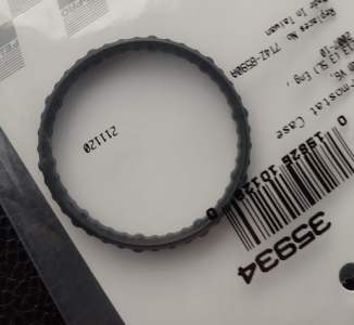

Drained the coolant, pulled the thermostat, threw it in a pan on the stove to test it, it didn't open even at boiling (212*F, the thermostat is supposed to be a 180*F), popped the new one in, popped the new "ribbed for her pleasure"
1671050536812
thermostat gasket in (WTF was someone thinking when they designe this?), tried to pull down a vacuum on it and it slowly leaked, so I pulled the housing and covered the stupid gasket with hylomar and reassembled, vacuumed it down, refilled with new coolant...
NO MORE OVERHEATING
YAY

You get a motorcraft or reische thermostat? If brick and mortar, those are off by 20 degrees.
