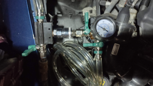

I bought a vacuum coolant dealeo, pulled it down to roughly -26inhg (-.9bar) according to the gauge. I let it sit for about 15min and the guage dropped about .5inhg (almost nothing, the rubber stopper didn't fit the tank well because the tank has a step inside it, honestly I was suprised it held that well). I eneded up pulling it down 2x and it sucked up roughly a gallon of coolant.
1670888727076
I tried 2 more times and the vacuum oraface sucked up a little coolant and wouldn't pull down below about -16inhg and it didn't suck up any more coolant.
