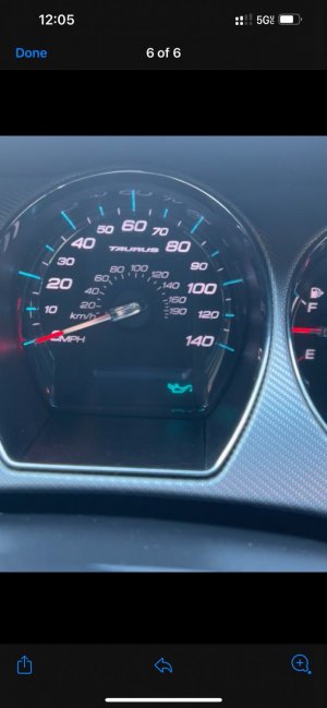

Hello. So recently i had an issue where my SHO 2011 with 118K miles on it started to have an issue with the oil lamp indicator. So I first added oil cuz i looked like i was a quart low after my last oil change around 3 months ago. Then i decided to just get an oil change to be safe. i did the oil change, and then continued driving the car. i do not know if somehow i checked the dipstick wrong or what, but i looked at the oil level and it looked full. anyways, a few days later it looked like there was no oil on the dipstick anymore after a few days and was so confused cuz there was no leak anywhere underneath the car. so I decided to add more oil until it was full on the dipstick reading. the car was running normal, started completely normally and drove perfectly fine. I was on my way to work when I decided to accelerate since a car was turning into my lane, and when i tried to accelerate, i felt a hiccup in the car and noticed my RPMS drop to 0. Then the oil light indicator came on, and i could no longer accelerate. i was able to safely pull over and park. i tried to restart the car again, and everything was reset in the car. my bluetooth devices were no longer added on for example. But, after i pulled over the car would not start. it would crank and crank but not start. there was still a full amount of oil in the car too when i checked. The next day i went back to where i left it, and the car did start but i noticed a large amount of white exhaust smoke come out from the back and the car seemed like it had a slight ticking noise when i tried to drive it to see if it would drive. I decided to leave it where it was so i wouldn't further any other problems. I am aware i need an 02 sensor replaced, but the car seemed like it was driving fine there was no performance issues until this oil light came on. there was no coolant in the oil either just an FYI. Anyone have any idead what it could be? Oil Sending Unit? Oil Pump Maybe? Or Oil Pressure Sensor? Im at a loss, about to have it towed to a mechanic tomorrow but want to know if the SHO community has any ideas! PS: there is no overheating, and the only codes on the OBD2 is for 02 sensor Thank you whoever reads this!!! Please Help!!

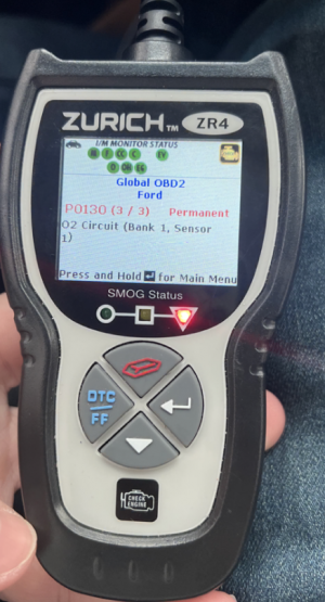

Check engine light? Any freeze frame data?
No check engine light only for my o2 sensor. Yesterday I started it up with no problem though. There was no more increased white smoke just a regular amount, oil was normal level, no overheating, no coolant issues etc. I drove it down a few blocks back to the house and everything seemed good. Still gonna bring it to mechanic tho but it’s starting up now. Most random stuff bro
