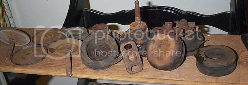

Heres my paypal receipt for the parts I got from Josh at SHONUT to rebuild my subframe mounts.
I had to grind (2) <1/4" Notches on all 4 corners of the subframe(peice of cake - just use a primer on the spot you cut before the new bushings go in). The design IS far superior to the Original bushings. The recall kits are HIGHLY recommended.

I beg to differ, If you are replacing your subframe bushings, they must be in pretty bad shape. When I took my bolts out...they were disgusting.
If yu wanna put this back into your car....go ahead.
