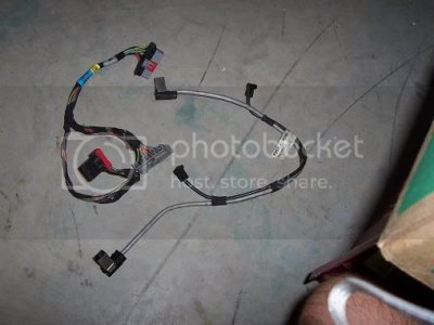

The cable on the left is the power and the one on the right is the data.
Radio001

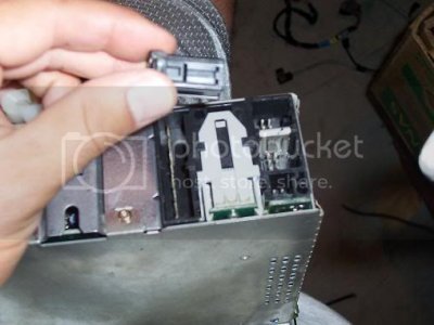

The plug goes into the upper right most slot.
Radio005
As far as parting with the power cable my Dad said he would but didn't give a price. Make an offer on it if you can't find one locally.

Matt, thanks again. I do in fact have the data wire, but not the y-type power wire. I also have the clip that you pictured, but unless I am mistaken, you have to pull that out of the radio and plug one end of the data wire into that port and the other end into the back of the CD player, right? Therefore, isn't the clip eliminated altogether? I bought the data wire(s) for $15, will that work for your power cable as well?

The clip is not eliminated all together. It comes out of the radio and goes into the CD player I do believe as it was installed in the factory CD player of the one I have.
