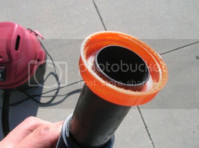

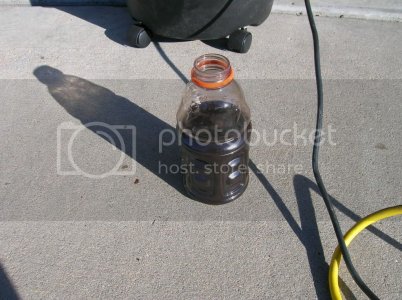

Make a vacuum can like I did. Was a real breeze to change the fluid. I also used this to remove PS Fluid on the 89, and the trans fluid on both the 99 and my Ranger.
Cut a hole in the lid of a 32 oz. gatorade bottle. Attatch shop vac to this cap. Punch hole in top rim of bottle, install 1/4 or 3/8" fuel line. Turn vac on. Voila.
